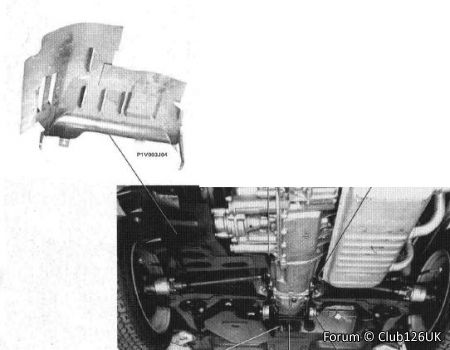

« Reply #54 on: May 14, 2008, 10:49:19 PM »
Just been browsing my manual, and i found out that my bis is missing a piece for the engine... a water duct guard or somethin like that... do you guys have it, is it crucial, the previous owners must have lost it :???:
Guido the Fiat
« Reply #55 on: May 14, 2008, 11:06:27 PM »
Yes mine has got one on, the cowling protects the radiator and water pipes from stones that might be thrown up by the rear wheels.
Guido the Fiat
« Reply #56 on: May 14, 2008, 11:13:50 PM »
I think it directs some airflow its sort of tinware too>?
Guido the Fiat
« Reply #57 on: May 15, 2008, 07:06:58 AM »
Yes I think air too, when my Rads fan is spinning air departs by the rear near side wheel.
Guido the Fiat
« Reply #58 on: May 15, 2008, 11:21:11 AM »
I wasnt thinking about the outlet that holds the rad. This one lies under the engine, and as pete said, probably just serves as a pipe protection...

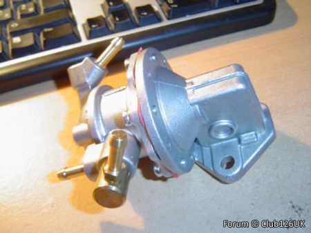

« Reply #59 on: May 21, 2008, 01:56:54 PM »
Just bought a new fuelpump for my bis, the old one failed yesterday whan it got hot, so i bought this one for 13pounds  :wink:
