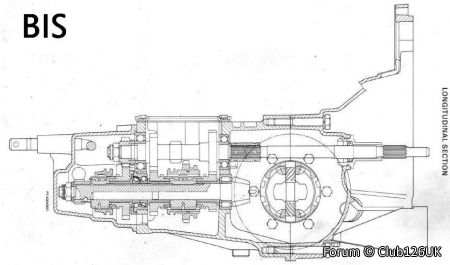

I have just found a 126 in the local papers for 50€ (in running order) so im planing to purchase it. now the question goes out to all forum members...
Does the aircooled gearbox fit the bis?
im gunna buy it on thursday, thats when the phone number will be public...

« Reply #10 on: March 04, 2008, 09:20:11 PM »
Yes it will fit, just swap over the bellhousing :D

« Reply #11 on: March 04, 2008, 09:29:19 PM »
YEEEHAAAA!
thats great to know, i just compared the two from manual pics i have and they do look the same  :D  :D  :D

isn't the final drive ratio different on the aircooled models?
Guido the Fiat
« Reply #13 on: March 05, 2008, 09:25:25 AM »
The final drive ratios are different A/c 4.875 against the bis 4.333  by fitting the aircooled box it will give you faster acceleration 0 to 60 in 4.2 secs (we Wish) :lol:  :lol:  :lol:  but knock the top speed down little, but i doubt that it would be that noticeable.
The only other option is to swop the diffs over as the gearbox ratios are the same on all 126 boxes :)

« Reply #14 on: March 05, 2008, 11:18:05 AM »
thats even better, i rarely get out of town with my bis so top speed shouldnt be a problem...
(come to think of it, ive never pushed it to the limit...  dont have the guts to go 200km/h in it  :D  :D )
i dont know if im going to swap the boxes yet, dont know how good the aircooled one is, but i wouldnt buy it if the gb doesnt fit...
