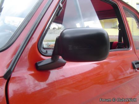

Just bought new rearview mirrors, 10 pounds, the old ones were not orig, and they kept falling down all the tima, theese ones are for a Yugo, but fit perfectly....

They look better than the std 126 mirrors Gordan.  :smt023  :D

well yea, kinda, but i wanted all orig parts, just couldnt find em...
the main thing is they dont fall down, so i see a little more than the road underneath me with em  :D

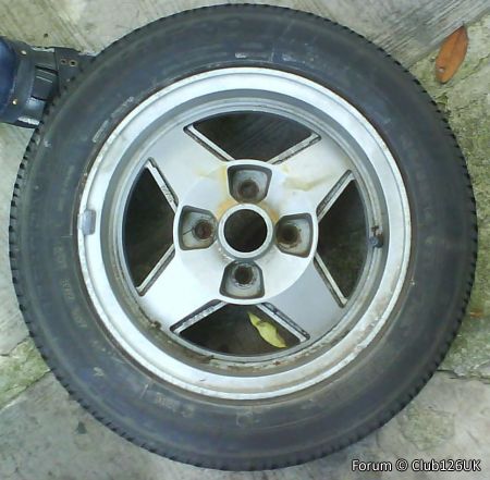

Guys, ive got a really straight foreward question for ya, will 165/65 r13 alloys fit my bis without any alterations, i found 5 of them for really cheap, but i dont want em if they dont fit...

Heres the wheel i might buy, gimme your opinion please, it looks kinda old to me...

The biggest tyre you can fit without fowling the wheel arch is 165x55x13. i have just changed mine as the 165x60x13 scrape on the inner front wheel arch on full lock, but that has solved the problem   :D  :D  :D

okay, thanx pete, tahat is one valuable piece of info, now just need to find alus that small... : (

i would suspect these wheels are 5j you'd just need to change the tyres on those and they be fine, paint the centres polish the lip= winnah!

Sorry for being such a rookie, but what does "5j" mean?  :roll:
Guido the Fiat
« Reply #71 on: June 20, 2008, 07:01:00 PM »
5 inches wide... :wink:
Guido the Fiat
« Reply #72 on: June 20, 2008, 07:04:45 PM »
5J is the width of your wheel, too wide and it won't fit, heres an alloy wheel guide
