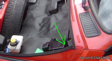

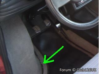

« Reply #38 on: April 15, 2008, 09:43:01 PM »
Still having those first gear problems, so I decided to take him off the road for a month or so till i get a new engine from italy.
This is a good opportunity to do some of the work i had been postponing.
It has been raining here non stop now for about a month or so, and my interrior (the left side)
was soaking wet. i opened the boot and found a lot of water just sitting there and turning my beautiful red BIS into a rust bucket. Plus there is a hole for wires that serves as a nice way for the water to get out of the boot- and into my interrior. Im waiting for it to dry, and then im gunna apply so much silicon on it that its going to reduce the bootspace by half >:)
Only prob is i HAVE NOO BLOODY IDEA where all the water is coming from. I glued that black plastic under the windscreen so its not it, and i covereed all the boot edges with some sponge... im quite confused....  :smt017
The second thing i did is take the seats appart. it turned up that most of the springs were broken, so i managed to make one like-new seat out of two... now i need to buy another one to finish this one....
The story of my car continues... andit will probably newer end...  :wink:
...EVER...
Guido the Fiat
« Reply #39 on: April 16, 2008, 01:36:41 PM »
normally the water gets in via the top windscreen seal runs around down the sides inside the rubber and at the bottom its normally rusted and perforated where the water seeps in down the wheel well and onto your carpets. remove your carpet and get a hosepipe and run water at the top of the windscreen and see if it does leak there if it doesnt try and find where its dripping in and follow it back.
