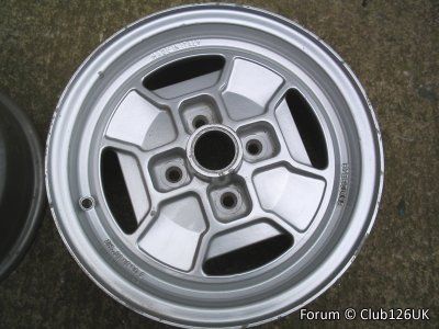

I have got a set of Fiat Uno Turbo Alloys fitted with 155 low profiles which I ran on a lowered 126 up for grabs.
Alloy wheels
« Reply #11 on: February 03, 2008, 03:07:32 PM »
I think there 4x100 alloys as it says to fit mini etc...
standard tyres are 4.5j x 13''    so im not sure if they would fit anyhow..
Uno turbo tyres! NICE!
