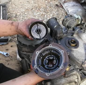

hi maxlee... sounds like you've found the centrifugal oil filter.. its behind the right hand drive belt pulley.. to get the back panel off the car is easy enough but a complete bar-steward to get back on!!  :cry:
see pic of mine bolts removed and filter cleaned, youll have to copy this link in google:
http://images.ofoto.eu.com/photos131/7/69/21/19/88/0/88192169733_0_ALB.jpg
the bolt that sits through the big compressed spring is a nightmare to locate  under the exhaust manifold and tighten down at the same time and you'll never do it on your own!   (in the end i used those plastic ties you can get either side of the spring and tried to compress it!)
don't know how you'll get the filter cleaned without removing the rear apron, so make sure you have the engine well supported on a trolley jack  because everything goes once the bolt is undone!
i used gunk to clean the filter and replace with a new seal,then tighten the cover back on, i bought millers oil, i think it was 20-50 classic, good stuff..
you may have read my post about gearbox oil.. make sure you can get the filler plug undone before you drain the gearbox oil out! it's located towards the engine obviously higher up than the drain plug which is clear to see..  the drain plug is a 12mm square socket attachment, the filler plug needs a 12mm female square drive socket or as 'Cars' mentioned the reverse of a 1/2 inch socket drive fits!
again i used millers gearbox oil (not hypoid) just a 70-80 grade..
hope thats covered it.. good luck!!   :wink:

ok the nocking sound is a bigend shell  :cry: so its replace them full engine rebild i think
i have got better pics of inside the filter for you chris  :D  send them to you 2moz as my hosting thing is playing up
all i can say is clean your filters i also have a pic of all the crap that i scraped out of it and its not pretty and i have fsh with it so fiat didnt do there job  :?
will put some pics up soon and right a bit more bout plans for the spair engine now we no how it all gose  :D

« Reply #24 on: July 25, 2005, 12:37:07 PM »
looks like fiat didnt clean it on the services  :roll:
after cleaning
as you can see from the pics the little fiat 126 engine is striped and soon to be cleaned

Excellent photos maxlee!
very useful for rebuilding etc..

that is fantastic!!!!!! pics are great!!

chris u are welcome to use the pics chap   :wink:
will take any more if any one wants any
my friend was going for the haynes look with the hands in the pics  :lol:  i'll get one of the drain bolt when my engine is back in one peace  :roll:
