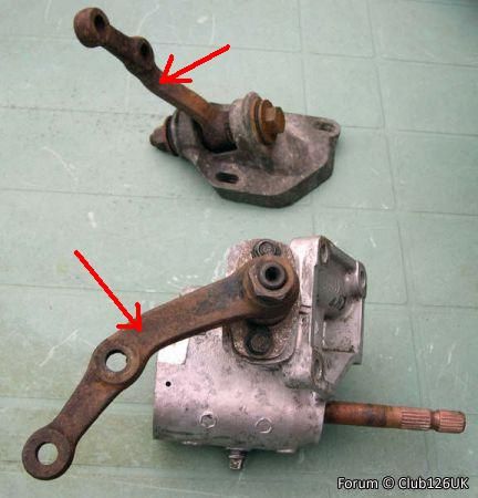

I joined this forum because we have a problem. We intend to speed-up the steering by changing the connection of tie-rods. However to do this we should also turn the idler arm by 180degree, or change it to a right hand side driven fiat126's idler arm. Is there anyone in this forum who can make a photo of a steering assy, in which the idler arm can be seen? I just would like to see how is it assembled in UK models.

Here is a pic of a rhd idler and a rhd drive steering box. I think that this is the only differences in the rhd/lhd drive setup? Perhaps another member can offer a better photo?
Another option may be the rack and pinion setup fitted to some of the later 126's

Chris! Do you know someone having spare idler arm and steering arm? I would need just the arrowed pieces.
I have a friend living in London, he may send them by post.
