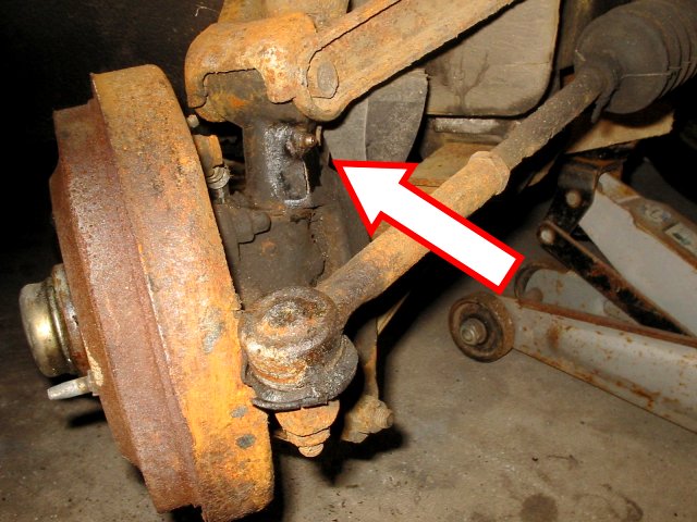

  • Posts: 68
What grease gun for the kingpins?
« Reply #10 on: May 30, 2006, 12:55:09 PM »
Well, I picked up a grease gun and grease cartridge to go with it at the local motor factors (£12.88)
Did the job last night - easy enuff thanks to Chris's instructions.  I seem to have the later type fitted to my '87 aircooled.  (I took a photo which I'll try to upload.)  As fiatfsm wrote, the grease did seem to mostly oose out of the top bush.  Hmmm  :???:
Next job is to check the gearbox oil level...
 :smt100
(gotta love the wee buggers)

gnash
  • Posts: 68
« Reply #12 on: June 04, 2006, 12:25:38 PM »
Here's a photo of the grease nipple on the driver's side of my 1987 aircooled.
