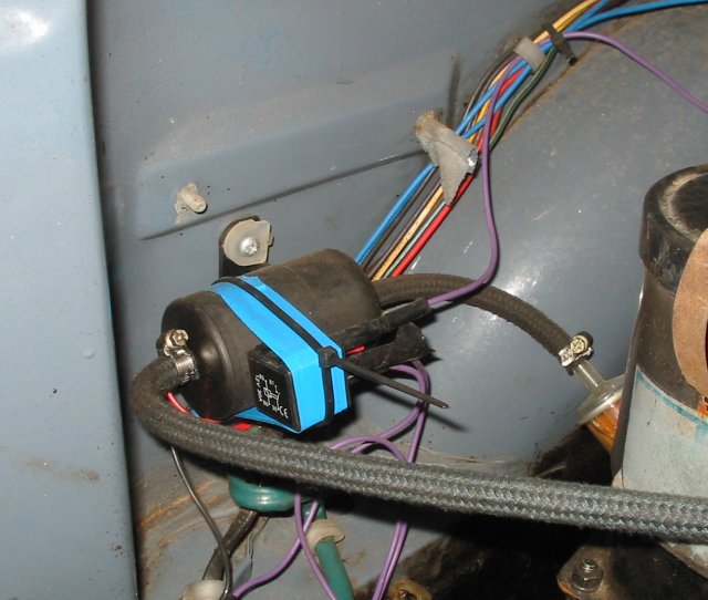

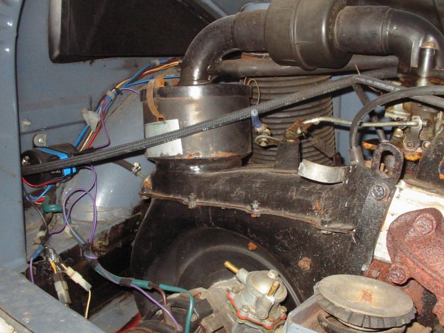

« Reply #15 on: April 03, 2006, 06:19:29 PM »
Here's the electric fuel pump fitted to my car.  The original pump is still in place.  At some stage I'll remove it and cover the hole with a plate I think.
(gotta love the wee buggers)

when i spoke to ricambio they said 45 for the pump and rod i think i will leave the pump where it is as it workin sound but gonna mount the eleccy one to the left inner wing as the fuel pipes are on that side anyway i will just swap the fuel pipes from the mechanical pump to the eleccy one if i need to shud be easier than changing a fuel pump at the side of the road and moving the dizzy to get at that bolt

on the subject of ''that bolt'' do what i did,take it out,grind the head so it clears the dizzy,cut a slot in it then you can use a screw driver to remove etc...............also,there are two nice 6mm threaded studs on that left inner wing to fit a base plate to take your lecky pump and earth,thats where mine is on the aircooled....i fitted new mech pump from gerstl (£15.00ish) to the bis.....im trying to keep that standard (LOL)
