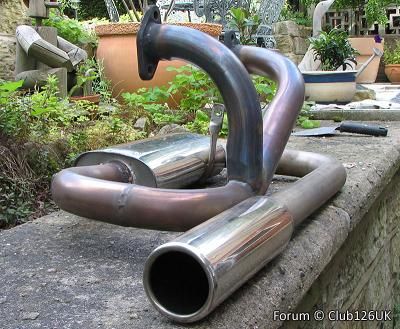

sorry, if you want simple tuning get one of these made like i did:
Slap on a universal air filter and adjust your carb!! hay presto... mine souds like a F1 car now!!! LOL  :D  :D  :D  :D

what carb adjustment needs to be made when fitting a sports exhaust?

the fuel needs enriched as the engine will run lean due to increased cylinder evacuation and the engine thus breathing better, so you would need to adjust eh primary and secondary jet on the carb
