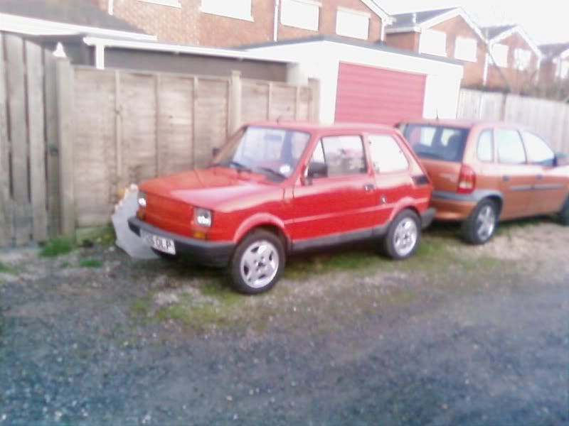

hi chaps,i've just bought a set of cinq alloys wiv 185/55/13's on expecting them to rub but they fit on my bis lovely,the only thing is as the overall diameter is larger than the standard wheels its made it higher geared and a bit slugish throught the gears,once the tyres need replacing i'll go for 175 50's i expect,,,just thought i'd let you know they fit :D  :D

« Reply #12 on: November 04, 2007, 06:52:55 PM »
Great news Dave looking forward to seeing a pic or two of the car with them on should look sweet

« Reply #13 on: November 05, 2007, 06:59:14 PM »
heres a pic mate,sorry bout the quallity,started mopping and polishing it today,,also fitted all the trim back on as i think it looks better,will get some better pics onces she's all polished up
