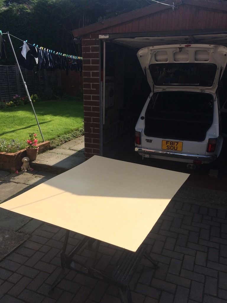

This weekend I decided to tackle a job that's been on the "to do" list since I first picked up Luigi way back in February 2013. Indeed it was the first job I ever did to it when I got it home. It's something a lot of 126 owners have had to deal with at some point and that job is replacing the headlining. Mine, like many others had the dreaded "saggy lining" and I remember very well driving the 150 odd miles with the roof lining draped over my head (hence why I ripped it all out as soon as I got home). It's always been a job I wanted to do in time and I decided this weekend it was time. I already had the materials ready just needed to do it so here's what I did :)

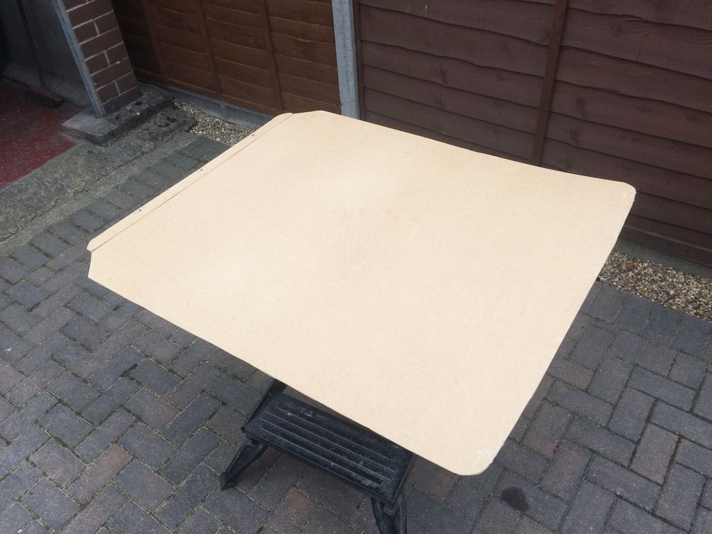

First I started with my board which was hard board the sort you buy from a DIY store with a shiny surface one side and a textured surface on the other (this choice of board would bite me in the bum later)
This was then trimmed down to size which took some time as it involved cutting pieces off and inserting it into the car until I got my desired size (I ended up cutting too much off the back so had to glue some back on DOH!) this was a fiddle going in and out the car every 2 mins and in retrospect a cardboard template would've been better but I don't have cardboard that big so I did it the hard way.

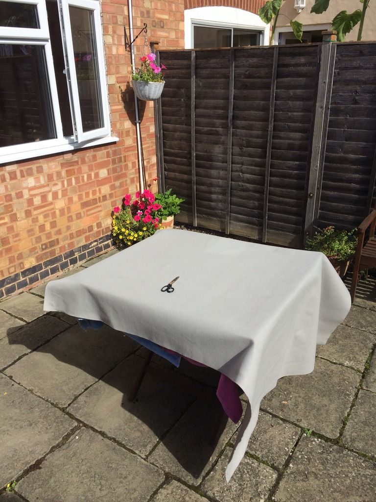

Next job was to lay out the lining material. This very satisfying job just involved cutting it approximately the right size and spraying a six inch wide strip of contact adhesive on the board and just rolled on the material spraying another six inches until I reach the other end. The edges were folded over and tidied up.

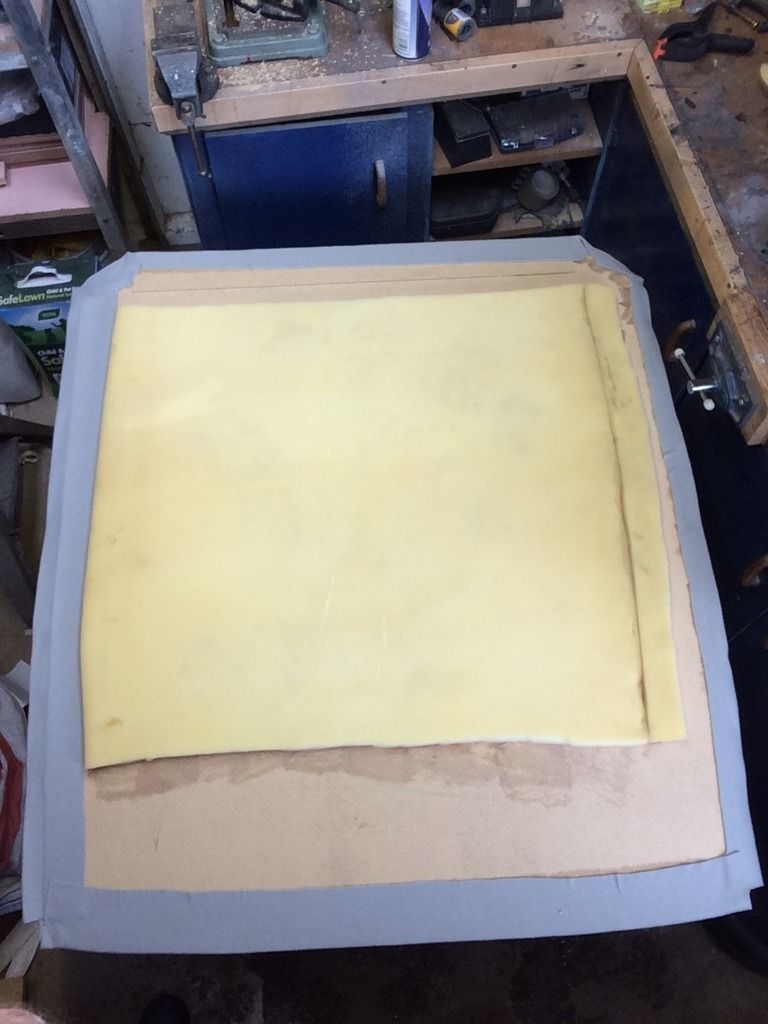

I had some foam knocking about so I stuck some on the topside (Roof side) to help with sound deadening. I rolled the edges over on the sides of the material to help it follow the contours of the roof line edge inside the car.

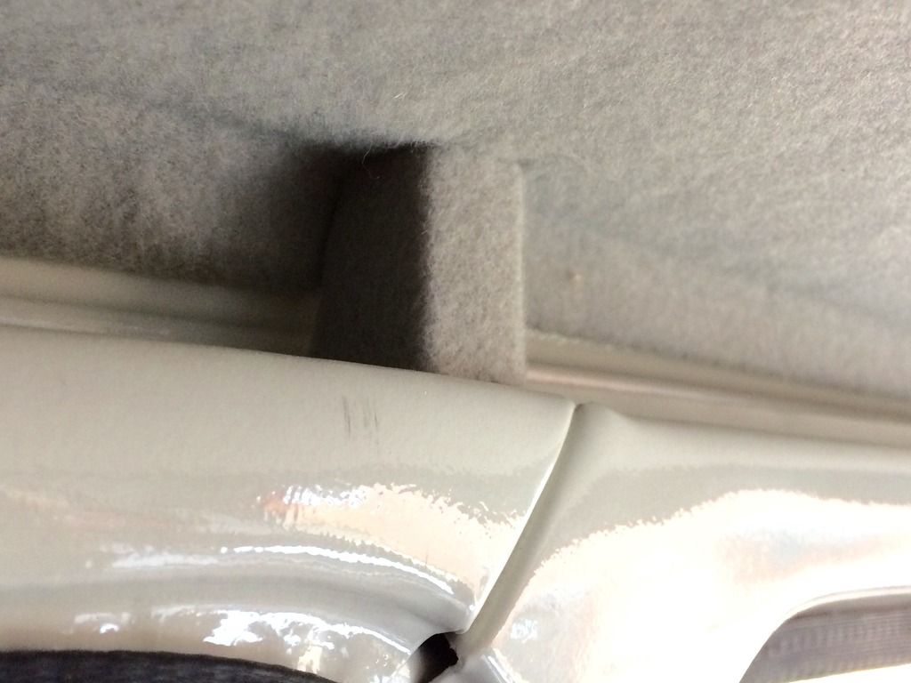

Once it was all fitted it looked great however here's were my choice of board bit me in the bum. It fits in lovely at the front as it slides in a gap just above the sun visors but at the rear it's only held in with three screws and with no support in the middle which meant the weight of the board made it hang down just above the rear seats :(
although it still looked better than bare metal I just wasn't happy so after some thought the solution was simple. I cut two small pieces of wood and shaped them and covered them in headlining material from an offcut and slid them in at the edges just above the doors and they did the trick in raising the board up and supporting it :thumbup

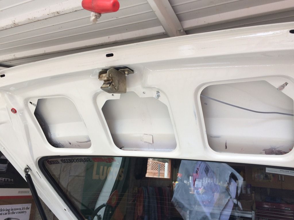

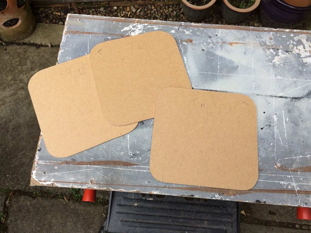

I was on a roll so I looked at tidying the inside of the boot lid up. These three holes always looked like there should have been something covering them only there never was so.....

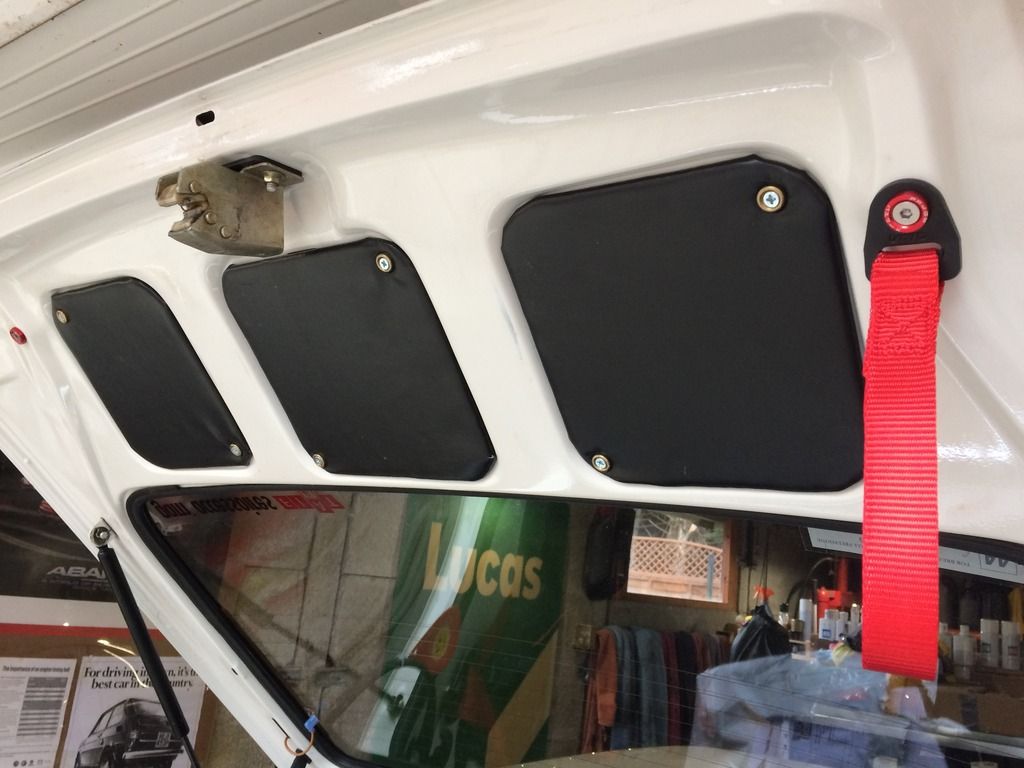

I cut these out of some offcut hardboard, stuck some offcut headlining on one side then wrapped the whole lot up in black vinyl I acquired off the internet for a fiver and glued it all up at the back.
Two holes were drilled in the corners and they then screwed into place. Job done and to top it off I fitted a pull handle - in red to match the seat belts - to the right.
Very happy with the result and I'm hoping for slightly quieter drive now the headlining finally in :thumbup
