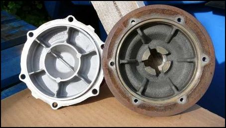

remove the front pulley (I removed the front pulley so non of the crap would fall into the oilways, this can wear the bearings and give you another headache) this is a pic of the filter the first time I cleaned it.
clean all parts and re-assemble
